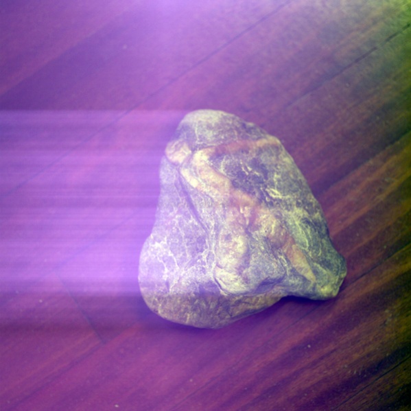

Hi, I have recently seen that using long exposures (1/4 sec and longer) I get some weird banding in my CFV images.
I am posting an image where you can see that the brighter parts of the picture are kind of motion blured?. I see this consistently, but only with longer exposures. Shorter exposures are OK and other than that the images are great.
Is this normal? has anybody else seen this? Do I have to send my back for checking?
thanks
If you use longer exposures than 1/8 you must change setting of your digital back. That all.
This sort of pictures are common too if you set 500 body when you use 200 body.
Last day I was surprised that my 2000FC/M works fin with my CFV if I set 500 body (not 200).
