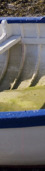

I bought this back just after Christmas, and have since shot about 100 frames. I did not notice the problem for a long while, as I edit and print only in B/W, not colour. But at 100% on screen, it shows up as an intermittent vertical magenta line, always 1/3 in from the left-hand edge of a landscape format shot. It is not a light leak or reflection, as it is hard-edged and is exactly the same whichever body or lens I use. The back has now been returned to Hasselblad UK, who in turn have sent it to the factory in Denmark under Warranty.
I am not intending to scare you, but it just might be worth checking your files very carefully. See the attached example section of a much larger image.

Good advice, but valid for probably any kind of digital sensor. I have seen this previously on Pentax, Nikon and Leica too. The fix is usually in firmware to map out a bad pixel which is not uncommon. I would be interested to hear what it is in this case.

Pure guessing here: could be sensor is bad, in the sense that a complete line of pixels which is driven/read in one go has a problem.

My CFV-39 was returned to me today. The repair took exactly four weeks, from my despatching it to Hasselblad to its delivery back here. After a great deal of testing and re-testing in Denmark, it has been fitted with a brand new sensor under warranty. I took some shots this afternoon, and all seems well.

Is your problem the same as mine - a vertical magenta line on part of the image, always in the same place? In which case it is almost certainly a column fault, and can only be cured by sensor replacement. If you read the Kodak tech sheet for these sensors, "hot" columns are not allowed to pass the defect check.
