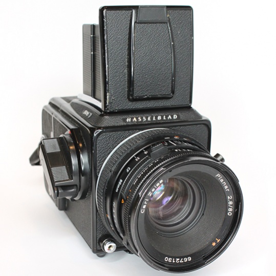

I looked at the online picture of this specific camera and on the lens it says: Planar 2,8/80 T* 6672130 and of course Carl Zeiss. I'm not sure if that's the information you need?
Tried to post the picture but that won't work (that is: I can't get it to work).

pic
There she is.. I did use the paperclip before but missed out on the extra tab that opened to upload the file.
In the online advertisement, there is no mention of CB of CF lense. It is mentioned though, with the other camera they have at the moment: 500CM + 150mm 4.0 T* CF But: when uploading the file I saw the filename and that did say CF, which I would really prefer given the very large prints I'm looking forward to make.. Another question for tomorrow.
The biggest difference (for me at first glance) was the (again: I don't know the English word, fortunately, you're Dutch too?) lichtgevoeligheid. The viewer of the 501 gave a much, much brighter sight. According tot the seller, that also was the case if the lenses were switched. Is that one of the differences between the 500 and 501?
And just a feeling: to me the camera looks used but not totally worn, that seems like a good sign?

This is a CF80 lens ;-)
The 500cm and 501cm have interchangeable focusing screens (matglazen in Dutch). The 500cm originally came with a much dimmer screen. The 501CM should have the AcuteMatte screen (there are people who put an old, much and much cheaper! old screen in a 501 before selling it....).
So, yes, the 501cm should have a much brighter screen compared to a 500cm with its original screen mounted. A lot of 500cm have been later upgraded with a new screen (note that these AcuteMatte aka AM) screens are not cheap, so make sure you get it with the camera.
A black Hasselblad tends to look worn earlier than the one with the chrome body rims. The paintwork is just more vulnerable to wear. I happen to prefer black cameras so I know from experience.
