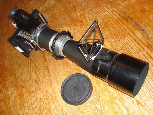

This One Arrived Today from KEH:
The 500mm F8 Zeiss Tele-Tessar. Really surprisingly light in weight, really same size, but a bit more in length, than my 350mm Tele-Tessar. Presently checking it out:

Most of it is air with a little bit of extra metal to keep the air in.
Due to its size people think these are heavy lenses which they are not.
They have only two lumps of glass, one at the front the other at the rear.
The 350 allows for handheld shooting.
That will be more difficult with the 500.

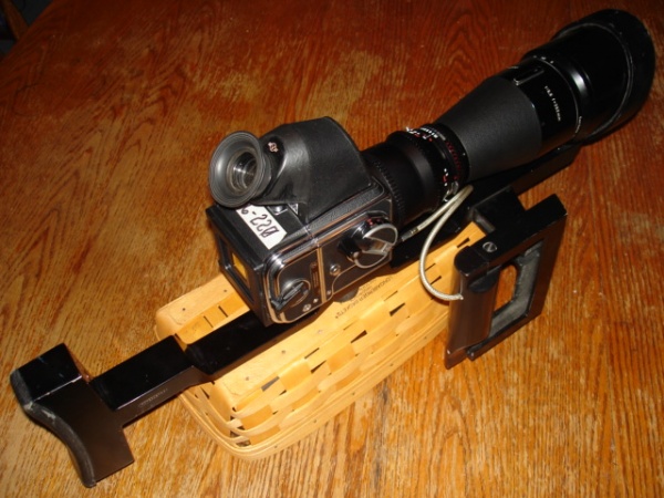

Meanwhile the Hasselblad Gunstock arrives. It's lightweight (hollow not solid) and some plastic, as well as the aluminum. Hardly a workout, weighs less than the 350mm and 500C/M.
Glad I have it! Needs a bit of TLC, but not too much.
