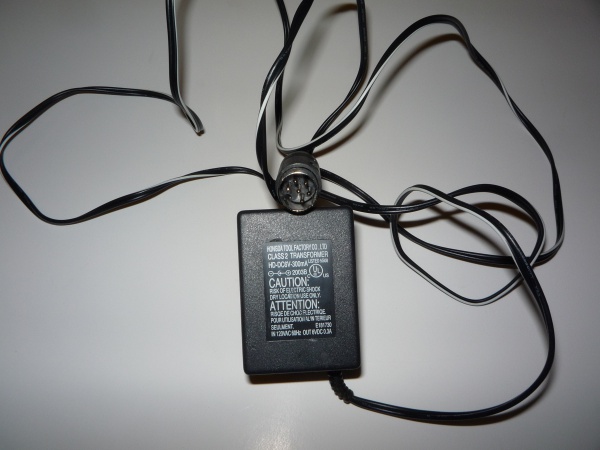

Here is what I have:
I never really read the back of this! It seems that this is aftermarket. It powers the camera fine just like I said.

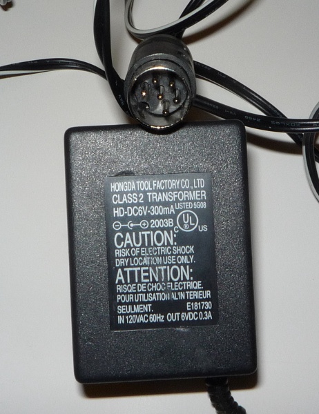

Here is a closer picture:

From the looks of things guys, I need to be looking for a charger! Can anyone tell me the differences and which one to purchase. Thanks

Isn't 6 volts of this unit the same as the battery? This is the AC cord I got with my camera. The camera was in MINT unused condition from someone who was not a photographer. I didn't know that this was not a charger but some kind of AC cord. It works so I'm going to use it and find a correct charger. Which of the 3 do you recommend?

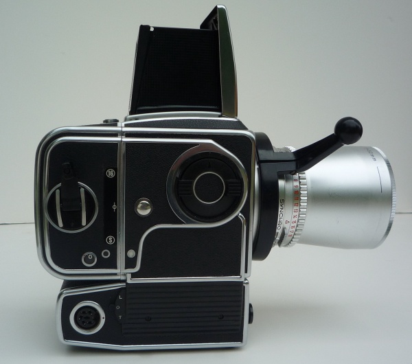

Here is my EL/M from 1983 with a MINT 50mm Distagon from 1964 and the A16S Back.

My official charger says 7 volts 50ma. Not sure what you have there.

You got me to thinking!!! I just plugged the cord into the EL/M and it's very sluggish. I have a working battery so I never really used the cord much as I shoot mostly outside. When I used it last over the spring when I first got the camera, it seemed to fire fine. I don't know what happened. The voltage seems to be not high enough to fire the camera correctly. The motor and the doors on the back move slowly. I will get rid of this cord before it causes something to happen to my camera.

50mA for sure is not enough to feed the motor of an EL-series camera...
The original NiCd batteries were built from 500mAh Varta cells. Using the
standard charging rule of thumb for NiCd (capacity in mAh divided by 10 =
charging current in mA) that fits nicely with a 50mA charger.
