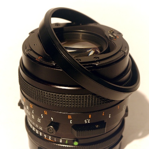

Your lens is one of many where this snap ring is missing.
Some traders buy and sell lenses without even noticing a part is missing.
The part your lens is missing is still available from Hasselblad.
Specialist repaircentres for Hasselblad have that part in stock.
It is a part that often fails. It can brake simply by lifting a lens from a bag or suitcase.
These incidents have given a lot of comment from owners not understanding that this can happen to an expensive lens.
Weak makers added to plastic parts tend to grow less active causing these parts to become brittle.
A small impact is enough to brake those rings.
Nothing serious just a nuissance that can be taken care of.
Depending on the lens the ring will cost 30-60 euro.
It is a press fit no tools are required, simple DIY job.

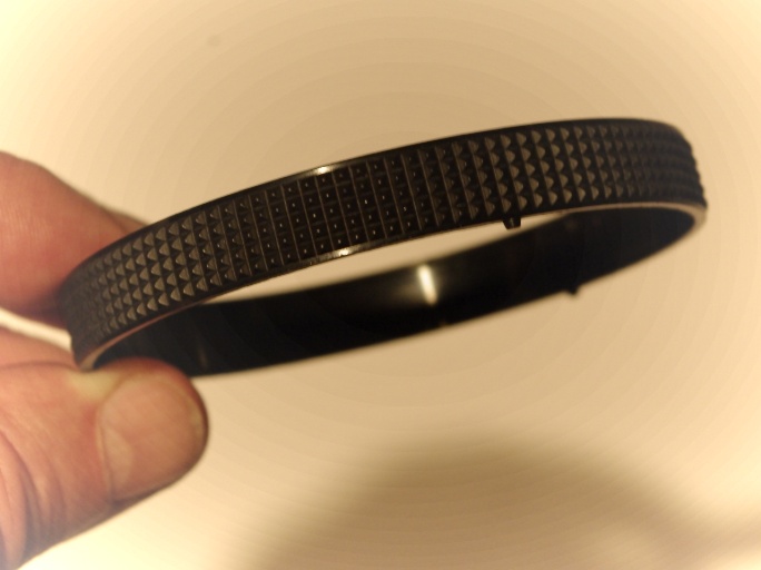

snap ring for 40/50/80 mm lenses

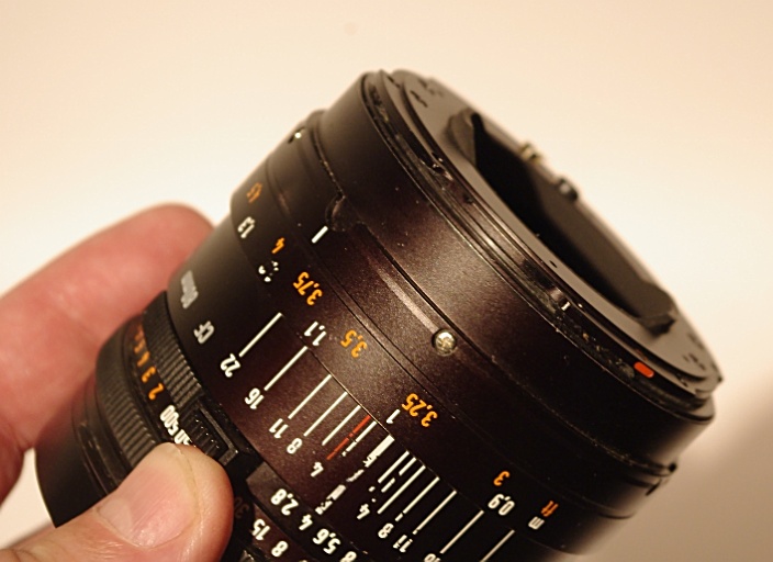

80 mm less ring

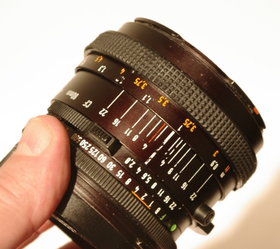

80 mm with ring fitted
