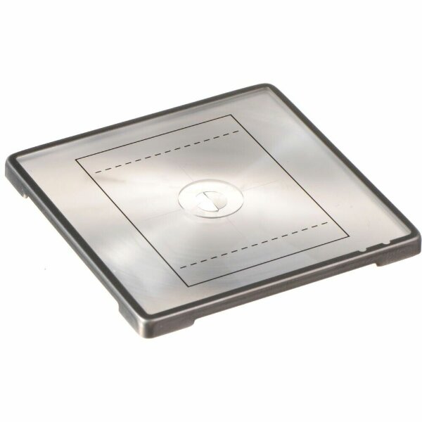

I'm using a 500 C/M with a waist level finder and a CFV-50c focusing screen – Im considering a PME3/5 45° Finder. I understand the meter is calibrated for the "acute matte screen"
Two questions I have:
1. is this focusing screen (CFV-50c) the same as the "acute matte screen" ?
2. If so is the meter in the PME3/5 acurate with this screen?
I would appreciate your knowledge and any advice.
Thank you

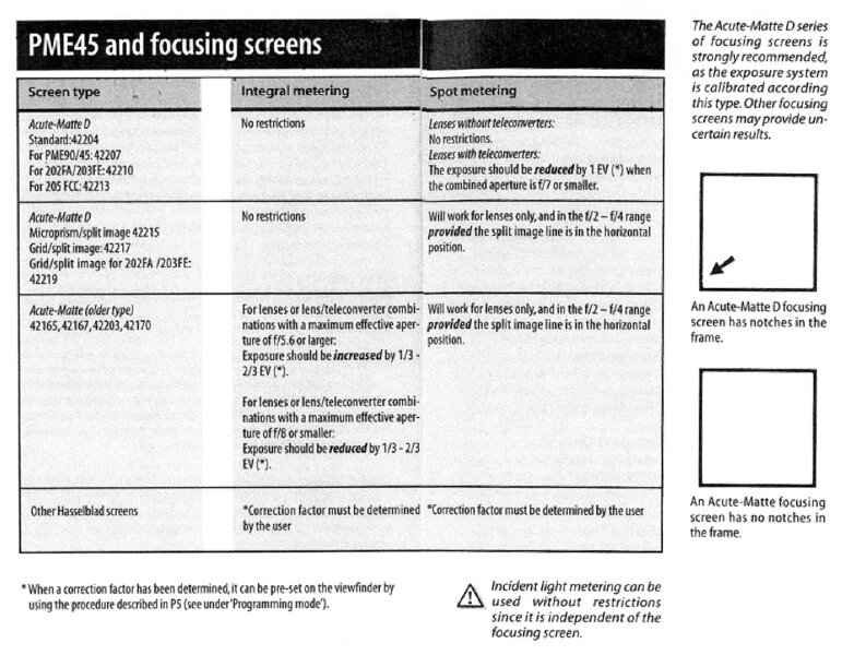

Here is a screenshot from the manual. I think it indicates you have to test to see what is the best adjustment. It has a little to do with the mirror as well. The glide mirrors have less vignetting in the view than the older mirrors (in the 500 c/m for example). You could use the average meter and compare it to a handheld in different lighting and see what the difference is for a starting point???

I am using a PME 90 with the CFV-50c focusing screen (which is simply an Acute Matt D screen with engravings on it. Note the two D shaped or half circle cutouts in the frame) and find the calibration to be correct, at least within the tolerances one would expect for such an old and essentially antiquated meter :) Also, as is the case with all old electronics, performance may vary significantly from sample to sample. If you are accustomed to using something like a Nikon D850 or some such which has a sophisticated scene recognizing ability you will need significant modification to your metering procedure :) Personally, if I were shooting transparencies, I'd probably select a good hand held meter instead.
Having said that, I use my PME 90 with a CFV II 50c back and find that I need to verify correct exposure visually. This could likely be eliminated by using a gray card or metering off of a suitable object in the scene. In any case, the PME 90 and PME 45 are essentially identical save for the viewing angle and both permit programming in a permanent exposure correction. If you find that you are over/under exposing when metering properly you can simply determine the correction needed and input the offset. The exposure correction is persistent and will not be lost when removing the battery.
