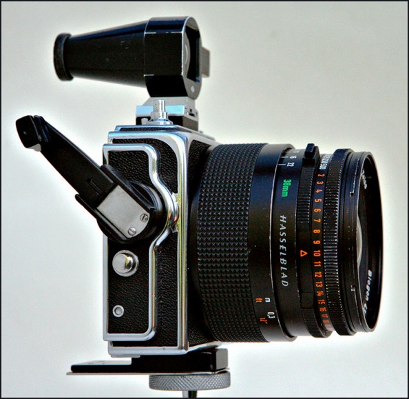

On my SWC/M you van see that the tripod plate is extended beyond the camera body and that's covered with a chrome plated plate.
The extension serves no purpose for me and my intention was to cut it off at the block. That wouldn't affect tripod use, but would make the SWC/M (now fitted with superb Voigtlander Angle Finder) infinitely easier to use as a street camera.
