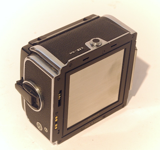

200 series cameras with light measuring systems also have 4 contacts at the rear side where the film back is fitted.
E or TCC backs have contacts to transmit the film sensitivity to the camera.
These contacts are being used to control the CFV back making use of the FE series lenses possible with CFV backs
This is only possible after the 200 series body has been modified.
After modification the ISO setting by the film back is no longer possible.
The 201F does not have the contacts and can therefore not be modified.
E12 TCC back
