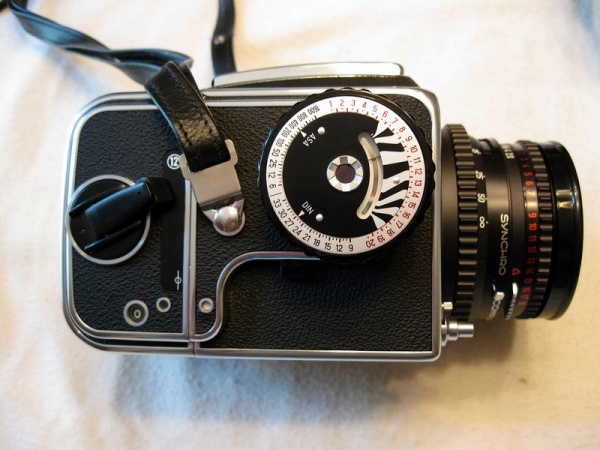

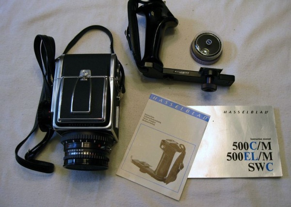

Well I just bought another 'Blad that I probably didn't need. The local Craigslist had one advertised and somehow I just couldn't help myself from calling the seller about it. The seller was making a trip that wasn't too far from where I live and he was generous enough to stop by with the camera. He was actually selling it for the daughter of an elderly gentleman that had passed away. It's a 1977 500CM with an 80mm f/2.8 C lens and included the metered winding knob and flash bracket. The seller had had a technician look at it and found the body was not operating properly as it appeared that it hadn't been used for a long time or it may never have shot a roll of film at all and the lube had stiffened up. The mirror was up and the winding knob couldn't be turned. The lens and back appeared to function OK.
The camera does look as if it had never been used, both inside and out and the lens and back were in them same condition. I asked the seller what was the best he could do for price considering the body problem and he stated $700(US). I had looked at prices online, so even with the problem this seemed not too bad even if I had to send it out for a repair. The wife wasn't too impressed that I bought a camera for $700 that didn't work.
Having disassembled a few 35mm cameras over the years for repairs I thought I'd see if I could get the Hasselblad apart and get it back working. I found several documents online that aided in removing the main assembly from the case, which was surprisingly easy. From there looking at linkages and pivot points using a service guide I found online, I applied a very small drop of oil to those points and gently moved things a bit to loosen things up. It evidently was enough as the camera now could be consistently cocked and fired as it should. Putting it all back together went well after I figured out that the lever that operates the mirror pre-release needed to be lifted to allow its button to be positioned beneath it.
I've noticed after removal of the darkslide several times, there's some black residue coming along with it, so I'll be ordering a seal set from ebay.
This is a good day, I'm happy!!!

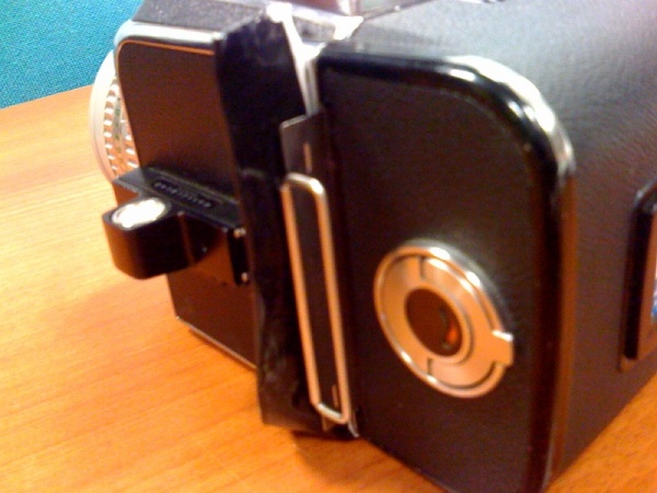

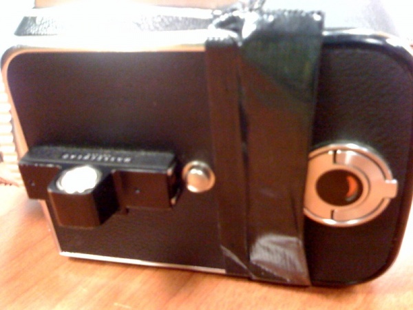

Thank you, Markf. I´ve ordered a seal for my Hassy. It´s true, its quite expensive for just a piece of foam and a plastic flange. Obviously, once I have it here, I will take measures and make my oun seals for the rest of magazines, and not just for the money, but for the shipping time to Spain.
Nevertheless, as I notice some problem of light, surely due to the bad seal of my magazine, I attach two pictures of what Ive done untill I can put the new seal.
Just a piece of black american tape. I take the inside mechanism from magazine, put the film and put it all inside the magazine. The light is blocked bu the black tape. The tape is folded on half itself, so it can be adhered to the body and leave a flap covering the aperture where slide is placed, as you can see on pics. Lifting the flap, dark slide can be put or removed in order to change magazine. The film can be changed with no need of puting the slide on and removing the entire magazine, just taking out the mechanism!
Once you hold the camera to take pictures the flap is pressed by your left hand on its natural position and no light can enter at all. In the case of using a tripod you can fix the flap with another piece of tape.
Obviously Hasselblad camera loses a bit of its glamour with this tape but I think it is a good remedy in the case the seal takes long to arrive o if someone don´t dare to change it himself.
