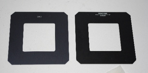

Hi, all - my proshade 6093T came with a mask for use with a 250 lens. Recently, I came upon a similar mask, for a 120-150 lens. Does anyone know if this second mask was actually supplied for or intended to be use with the 6093T?

I just received the 2 older masks in the mail this afternoon and the first thing I did was to compare the "old" 250 mask with the new one I just purchased from Hasselblad USA. Surprisingly, the cutouts were different sizes. If in fact the cutout size is a function of the lens focal length and the amount of extension of the proshade, I would expect the cutout sizes to be identical. The newer model has pronounced radiusing of the corners and an extra 1/4 inch width and height in the opening, as well as a tab to make grabbing the mask easier. I'll take some test shots to see if I get any vignetting with the older mask.
All masks (old and new) say "CF and C" in the engraving.

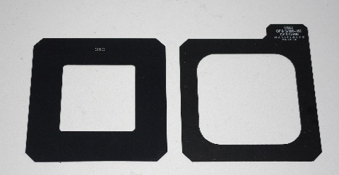

Here's a snap of the masks, Paul. The 250 mask with the tab is part number 3040312. It has the larger opening of the two 250 masks.

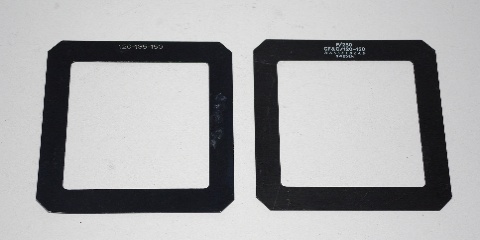

I found a selection of masks that makes the choice even more difficult:
Old 250 mask for pre 6093 PS later labelelled C & CF 250
Suitable for the 40231 and 40676 PS
Old 120-135-150 mask, later labelled F250 and CF&C 120-150
Suitable for 40231 PS (not F250) and CF&C 120-150 + F 250 (40676 only)

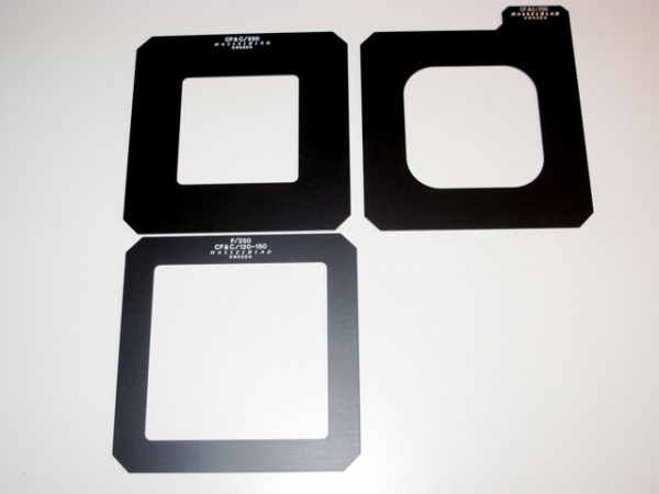

Left old 250 mask.
Right F250 with CF&C 120-150 and CF&C500
This one seems different from the 40312 mask.
Due to the larger opening needed for C500 and CF500 lenses this mask is meant for the 6093 (T) Pro Shades.
It seems to have a larger opening than the 40312 mask though.
Apparently the 40312 is not in my collection.
