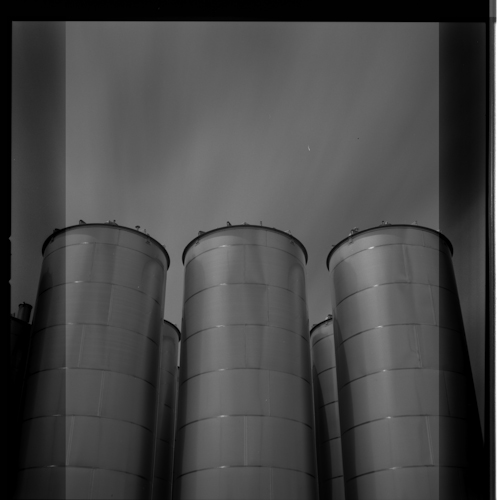

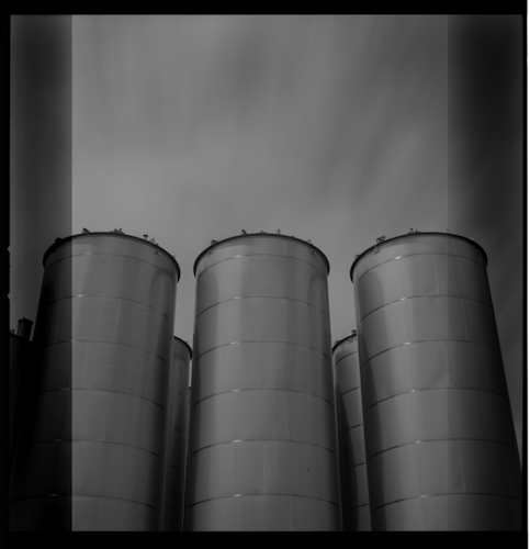

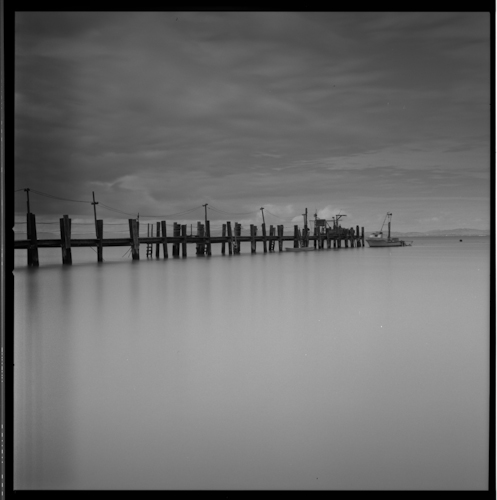

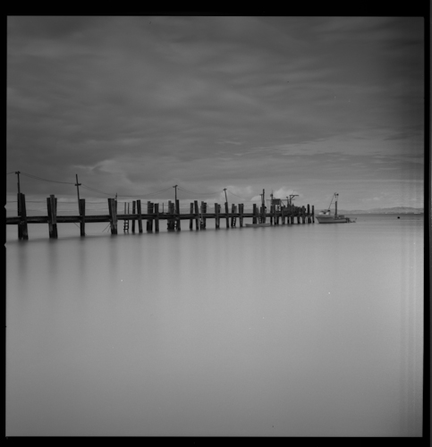

I am including 4 images, scanned from two negs. I noticed these lines on one side of an image, then just a few minutes later I noticed the same lines on the opposite side. After scanning, re-scanning, I finally decided to try scanning a neg from my Mamiya C33... Nothing came up on that scan. I ran several tests with different film manufactures, and even tried a different lab for developing (soon to try my own developing).
Well... Here are the specs.
Two negs, I just switched positionson the neg holder.
Epson V700 scanner
Hasselblad 500 C/M
A12 back
Fuji Acros 100
80mm 2.8
Any ideas? I darkened the sides so you can see.

At first sight I would say the lines were caused by some failure in developing.
The scans from the cans made me doubt.

The body and back are date coded from 1972. Unfortunately I do not have another back to try. I know I need to have the camera cleaned and checked out, but after some tests, I think it may be the scanner. I too thought it may be a developing issue, but after a few tests with scanning, I noticed that the "bars" switched sides when I switched the negs in the film holder. My guess is that if it was a body / back issue, the bars would stay in the same place regardless of positioning in the film holder.
