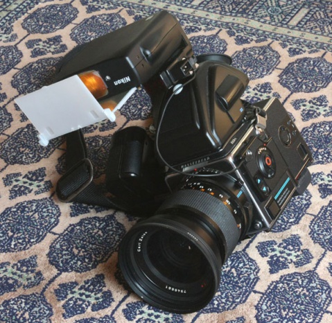

Well a week ago I have to take pictures for the annual party. I analysed the pictures made years ago by another one at the same place with a Nikon AF and noticed that 90% of pictures where made with the same issue (thanks to exif info !). So I made the equivalent with this:
A CFV-39 at 400 asa (in artificial light setup) with my 50mm 2.8 motor and flash. As I could analyse the light, I use a filter on a flash to give artificial light to mix with the light of the room. So 90% of my pictures were made at 1/30 F 1/9.5 Flash at M/2 (half power in manual mode) with winder and PME viewfinder. The PME is really a pain to work with as the view is too small to focus correctly but this viewfinder is helpful to handle the SB-27 flash. I never use help for light measure except the histogram of the cfv-39. All pictures were perfect exposed with this manual mode. Most of time I setup the distance to 1.4m and put myself at 1.4m of the subject then I made a picture like this and an other one focussing "TTL". A very good idea to works fast and anyway the set up was not bad at all (80% ok) BTW the problem is not to focus perfect, but to have eyes of couples at the same distance ! I mean that If you have more than one persona on the picture, one is sharp others not as sharp !
The bad point is that a 40mm should have been better with the 36x48mm CFV, and buffer of the CFV is just not fast enough when you use the "speedy" 203 winder.

In fact with this stange flash, you have reflector in 2 parts. And I use it like you can see on the picture. So the cell of the flash can't works.
