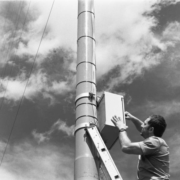

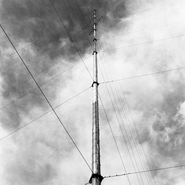

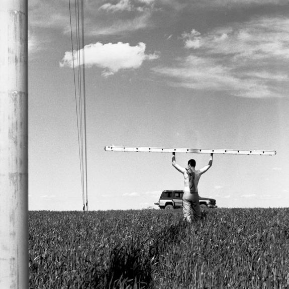

Here are some examples of how a red-orange filter would look like on human skin. These are plain scans, without any alteration.

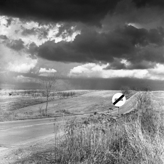

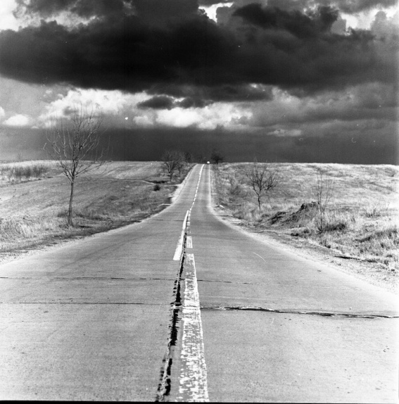

And here are two more landscapes with the same filter. Again, without any alteration. Overall, this is one my favorite filters, followed by the yellow one.

Thanks for those examples! That's not too bad. I thought the skin would be more blown out.
