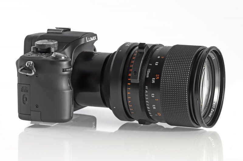

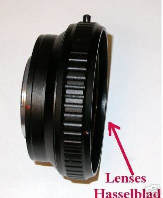

I have tryed the adapter yesterday evening successfully with my Planar 80, I was able to close and open the lens as requested.
My lens is as the one in the attached picture.
But I haven't find the solution in my Distagon 50, in the past I never had the need to discover if it was possible and now I'm not prepared to solve the problem :). The lens is as the one in the second picture.
