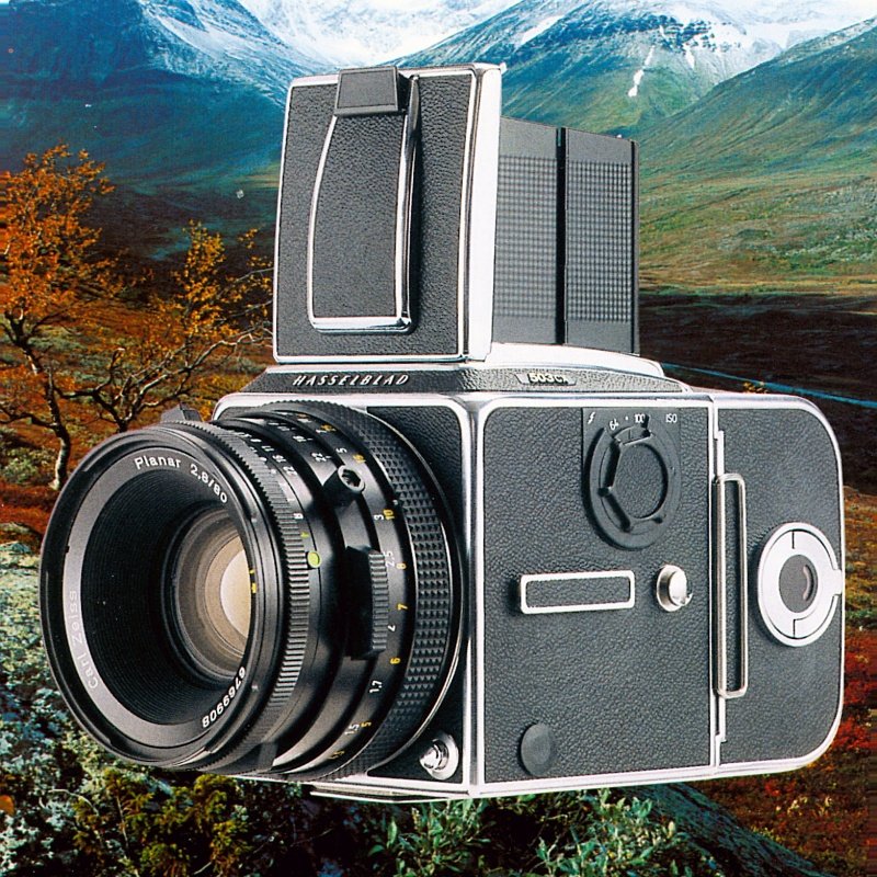

If your camera has the 80 mm lens from the same period it will look like the one in the image below.
The DOF selector is the small black control in the middle of the lens.
To close the aperture to the preset value simply slide that control to the left.
To open the aperture again a little push on the left hand side will move the control back to the right and open the lens.
